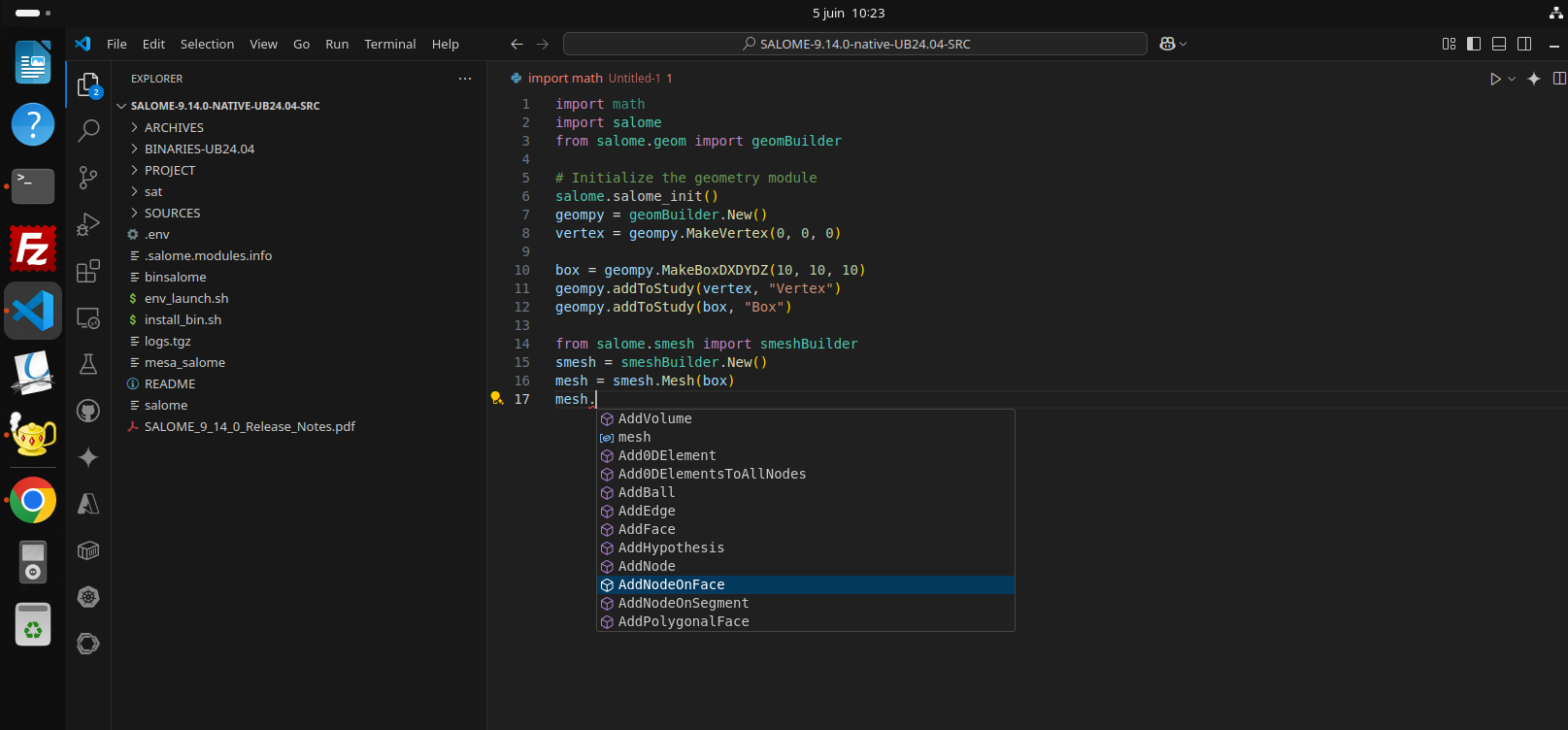

Development concerning this is underway. In the meantime, here’s a tested solution (Ubuntu 24.04) that I use and which might help you. In addition, hovering over a method will also bring up a help pop-up…

  • Create a python script and start typing. Completion should work.
