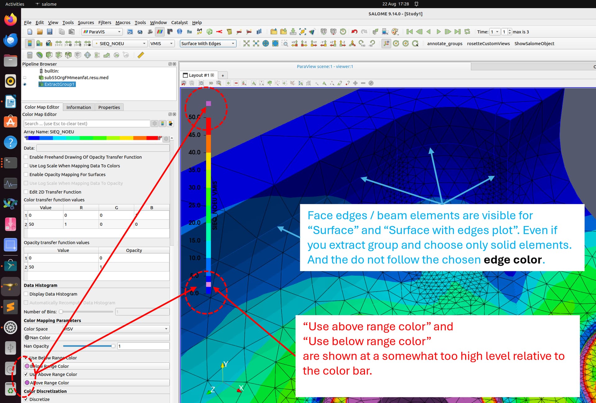

Hi, two display issues:
1. The “Use below range color” and “Use above range color” are shown are shown at a somewhat to high level relative to the color bar. See attached picture. This was not the case with in Salome 9.12. They are shown correct if you choose horizontal color bar. -Is there some workaround to adjust this for vertical color bar?
2. Face edges / beam elements are visible for “Surface” and “Surface with edges plot”. Even if you extract group and choose only solid elements. And they do not follow the chosen edge color. See attached picture. I can solve it if I display wireframe filter at the same time. -But is there some better way to adjust this?
BR/Micke
The picture/Micke
For information: I think it is when you ckeck “Draw Annotations” or “Automatic Annotations” that the “Use above/below range color” jumps to the wrong position.
BR/Micke
I do not get it. Seems random how the above/below range colors jumps around. Often works ok for SIEF_NOEU results but not for SIEQ_NOEU results. If I choose “Save current color map settings values as default for all arrays” for a SIEF_NOEU and then switch to SIEQ_NOEU the colors jumps….
