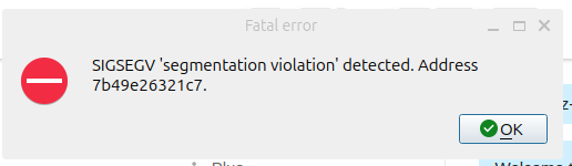

I have just downloaded Salome 9.14 for my Ubuntu 24.04 laptop and it launchs when I run ./salome, so not so bad ! Unfortunately, when I go in the Mesh module I have an error message which makes impossible to use the software :
Any idea how can I fix that ?

Could you please check if running mesa_salome helps resolve the issue?
If it does not work, please provide the following informations such that we can investigate further on our end:
  • list of installed packages
  • output of env
  • output of cat /etc/os-release
Additionally, could you tell if your Ubuntu 24.04 installation is running on a virtual machine?
Regards.

Form the env output, you seem to be running wayland as display server.
XDG_SESSION_TYPE=wayland
As it is discussed in other threads, either use the universal binary or change from wayland to X11.
See this thread.
Dear Nabil,
THANK YOU, I have changed from wayland to X11 and it works, so great :slight_smile:
Problem fixed !
