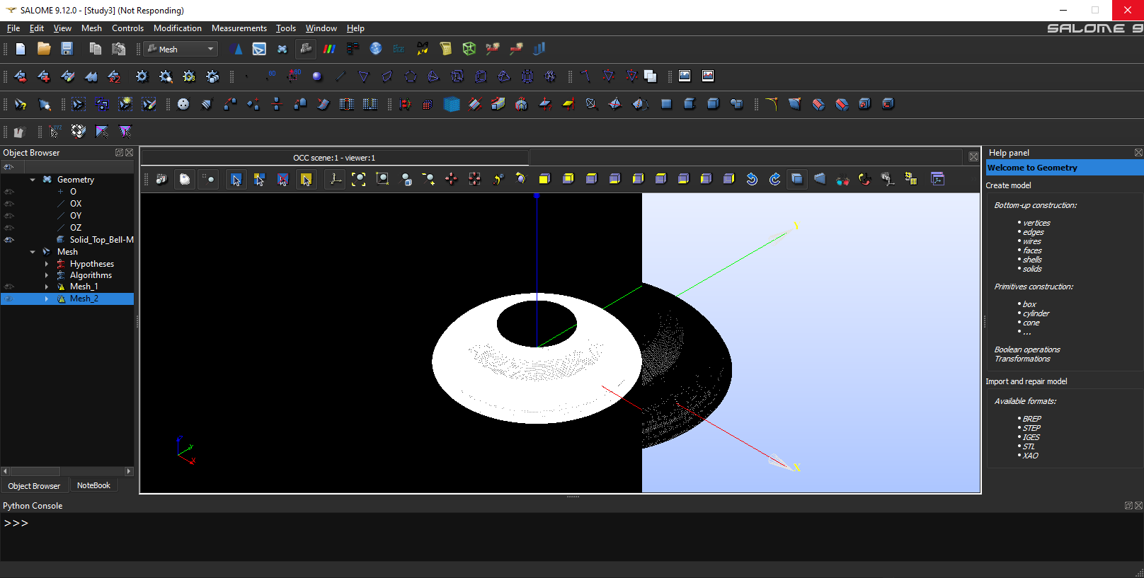

SALOME not responding for over an hour. Is this to be expected?
Newbie here…Is it because of the initial conditions of my geometry?
I’m thinking the kill_salome batch file was created with this scenario in mind.
Thanks in advance.
David
Edit: It finally failed after several hours.

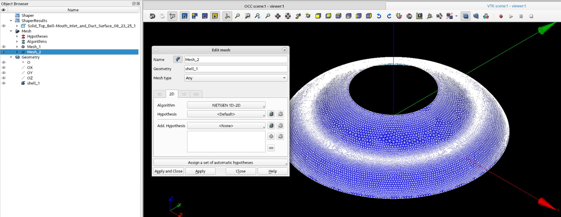

Hi,
you may have asked for too many elements (or too small mesh element size).

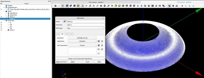

First create a mesh with Netgen 1D2D, without any Hypothesis. Right-click Compute. It should be generated in less than 10 seconds.

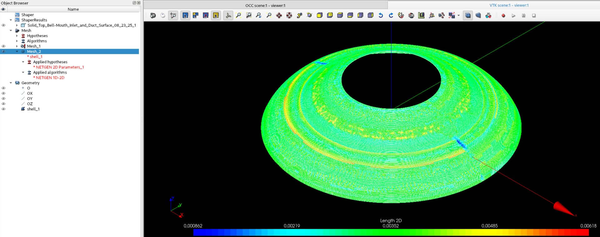

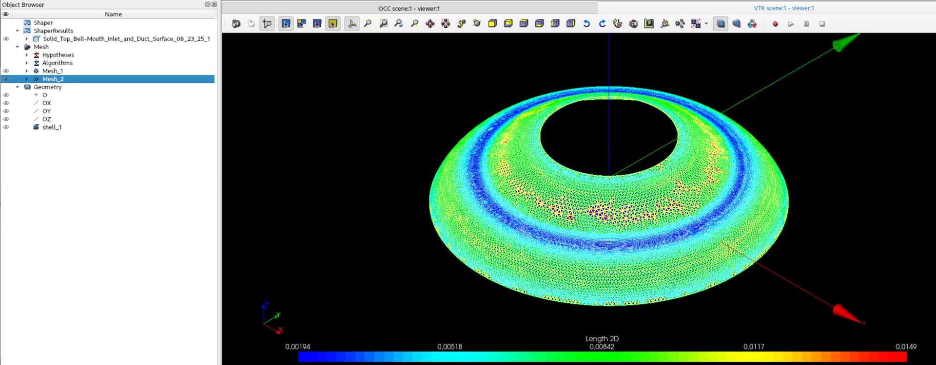

Right-click on the view Controls> Face controls> Length 2D to see the current size of the elements.

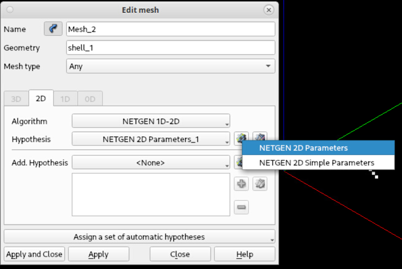

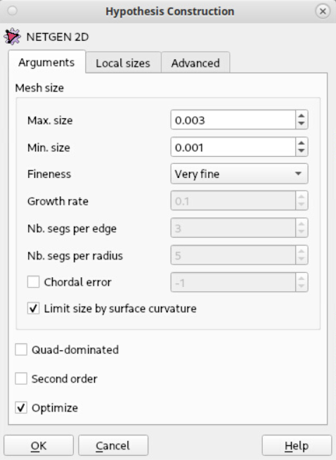

Then edit the mesh to add a Netgen 2D Parameters hypothesis to adjust the max size to your needs.
The mesh has smaller elements (but takes more time to compute).
