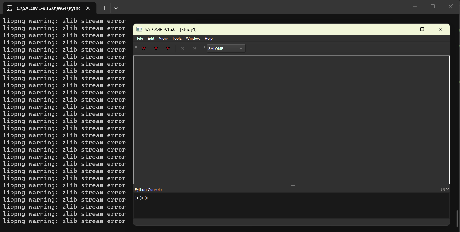

I just installed 9.16 on Windows 11 and got this error when running Salome:
libpng warning: zlib stream error
And all the icons are missing.
Does anyone know how to solve it?
Thank you @jcsaaver for having warned us know about it. We reproduce the issue, we are going to fix it.
the reported issue regarding the Windows distribution has been resolved. I downloaded SALOME again and can confirm that the error no longer occurs.

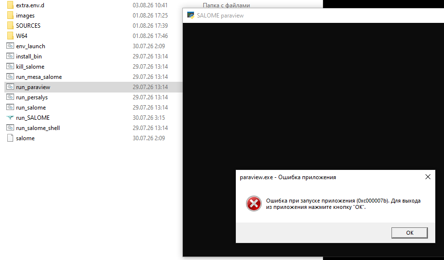

In updated release of SALOME-9.16.0 for Widows “paraview.bat” failed to start.
Solution: copy of onnxruntime.dll from “W64\ONNX\lib” to “w64\ParaView\bin” folder.
Thanks for reporting about this issue which is obviously a bug in run_paraview.bat…
new archives containing the fix have been uploaded to the site.
