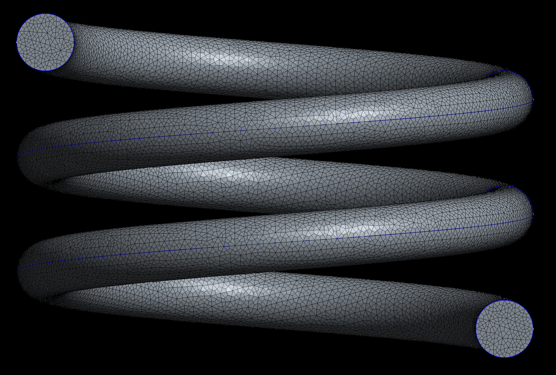

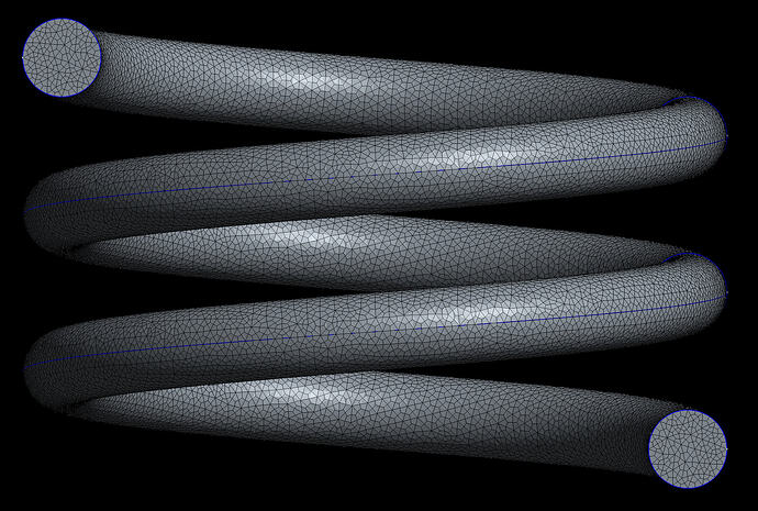

Hello Nayoung,
did you mean:
or
Regards,
MJB

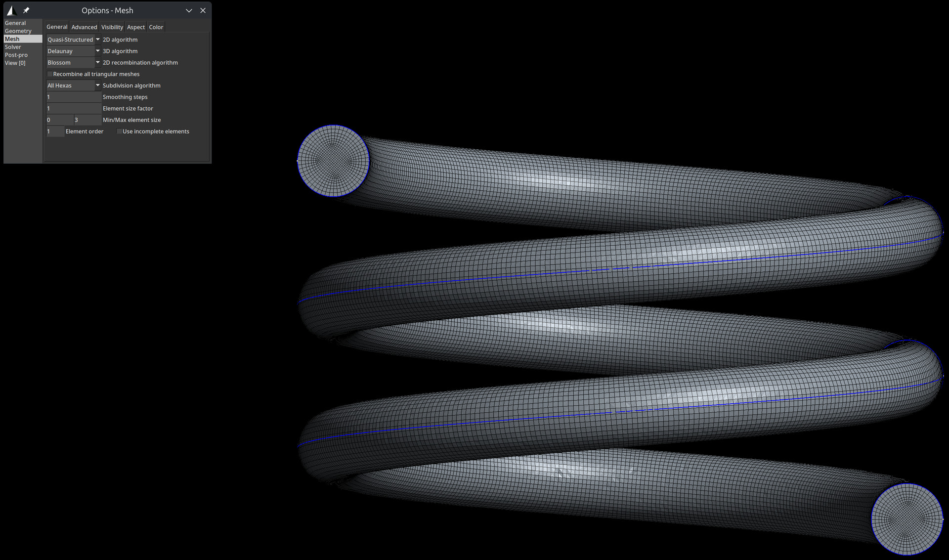

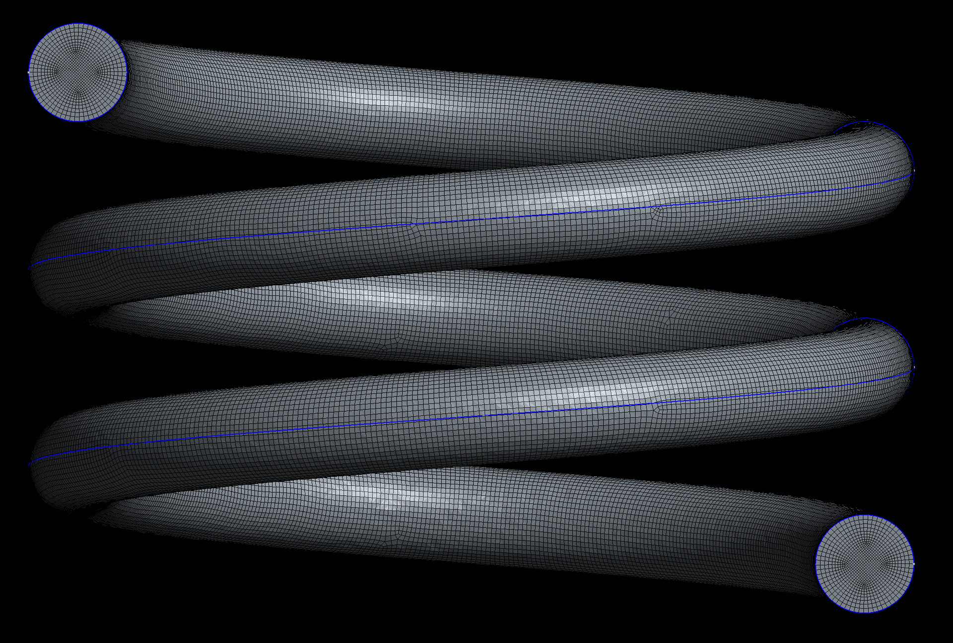

Hi,
Could you share scripts for 2nd case(which is by GMSH I believe) as well as all tetra mesh using NETGEN if possible?
I find its rather difficult to control sizing using GMSH.
Thanks
Anirudh
Hello Anirudh,
… voila
Regards,
MJB
