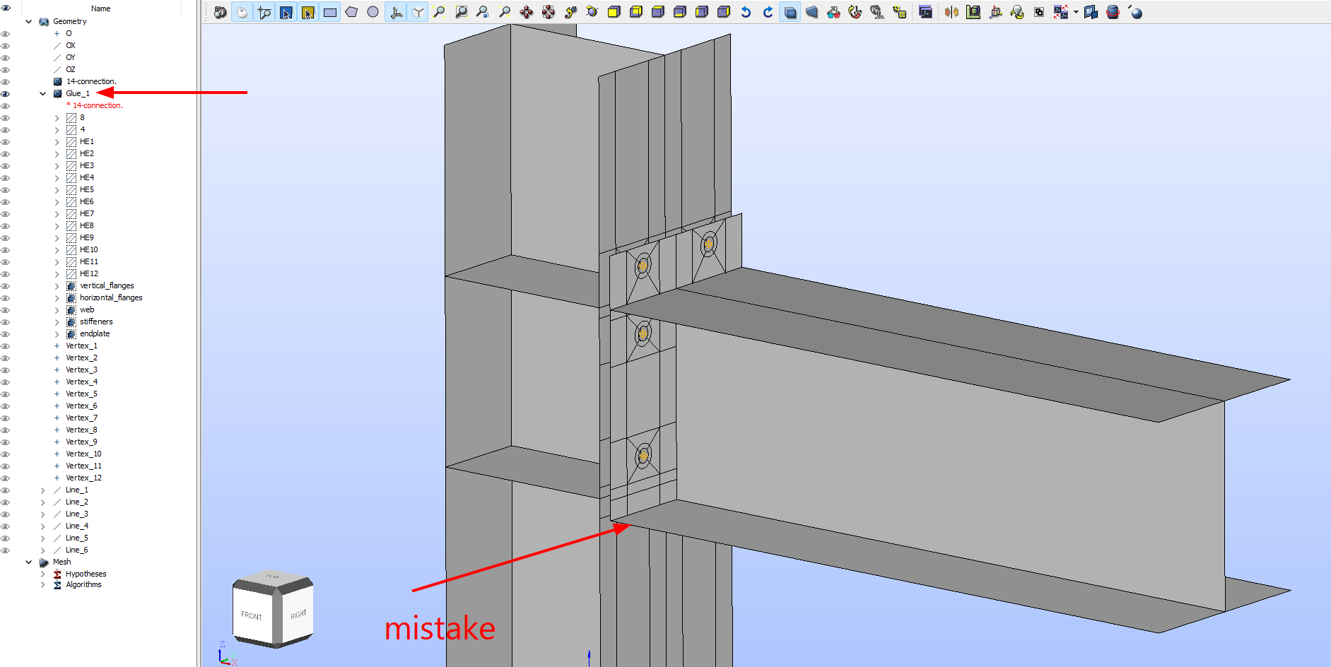

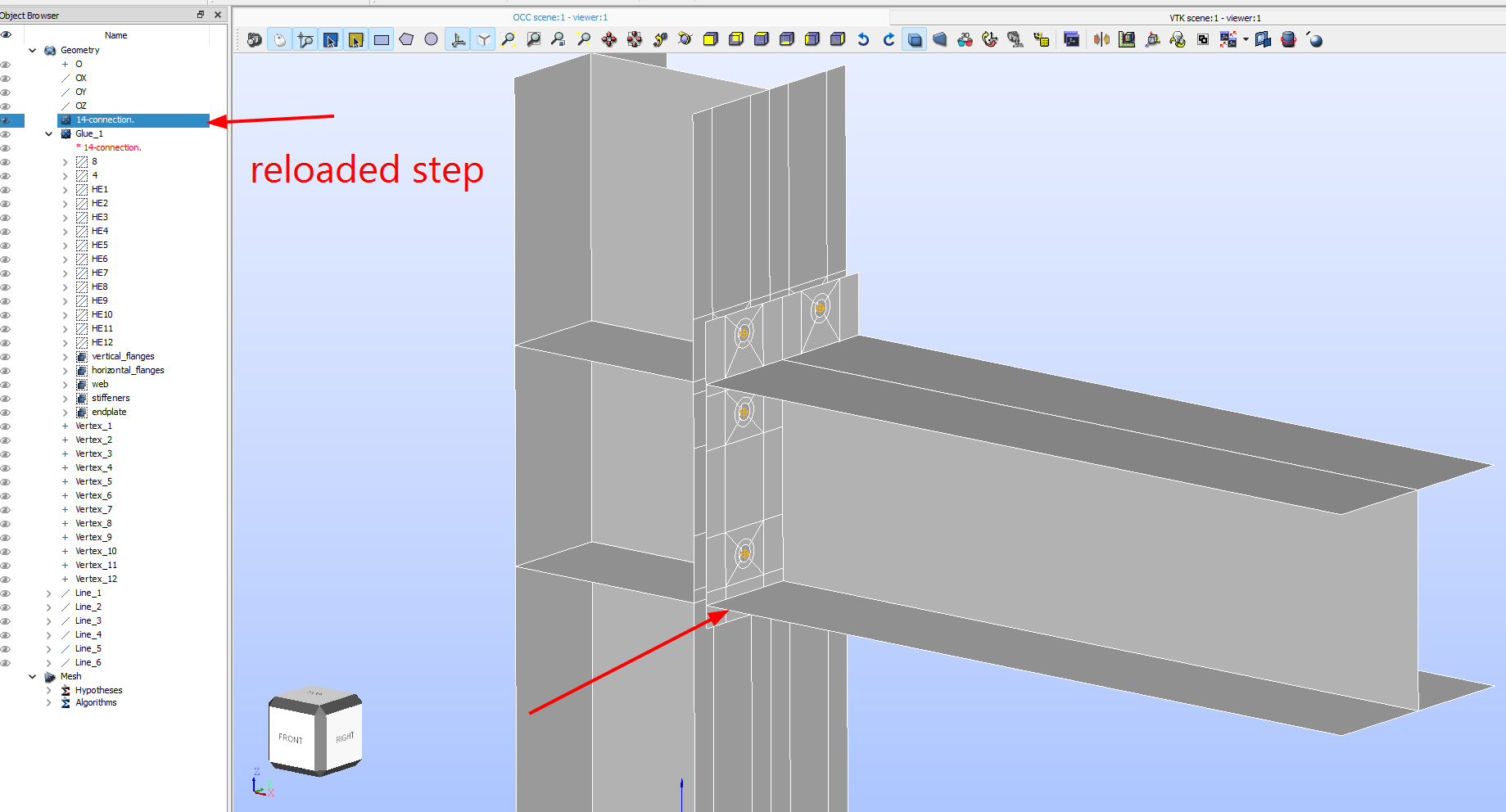

Hi. I need help exchanging the geometry in glue operation. I made a model outside Salome, imported a geometry, glued free faces and added all the required groups to Glue_1 entity. Now I spot a mistake I made. So I changed the model outside of Salome and reloaded the step file from disk. Since all the groups are connected to Glue_1 and God help don’t want to recreate all, I’d like to replace geometry on which Glue_1 is based.
Is there a way to do that?

Most of the time I’m designing “stuff”. When I have to check something in FEA I create a proper model in CAD and export it to step. If something needs to be corrected in the design I correct it in CAD, correct the model and export it to step under the same name as before. Then I reread file in Salome and may continue. The problem shows when I have to add an operation in Salome to the model I imported. Like Glue in the example above. Then I may reread the step, but the changes done in Geom don’t propagate. …and I haven’t found a good way of working with Salome, when the model is changing. Maybe you have a workaround to that?
for your use case, python
Well, it is the same most of the time. I’m not losing groups when I reread the file. Only when an operation is included, then we have the situation as above.
