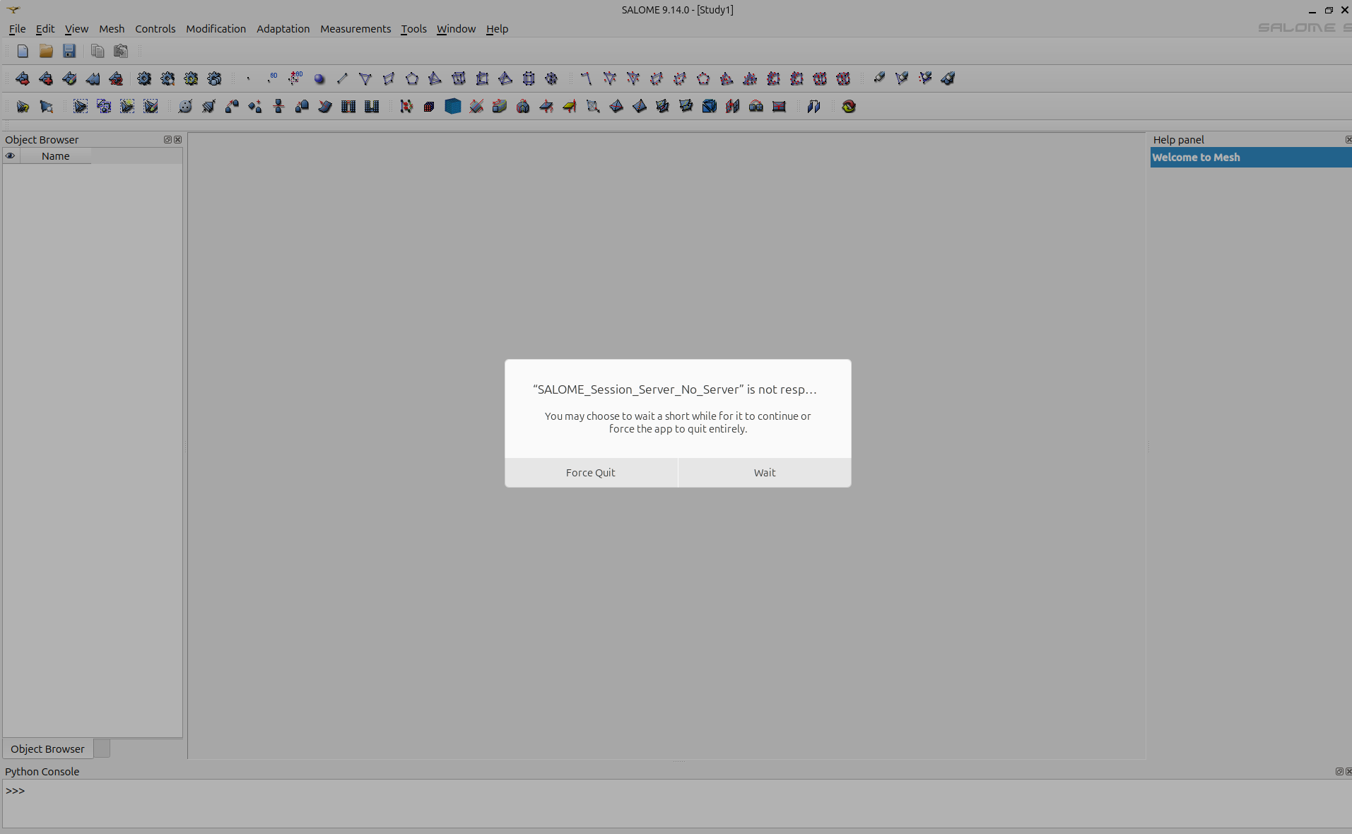

However I have a problem with the graphic window. The window close automatically.
For example if I choose “MESH”, I get the window in attachment.

hello,
most probably you are in wayland and the ubuntu version, it is know that this happens, if you need to stay using wayland, you can use the universal linux version that will work.
