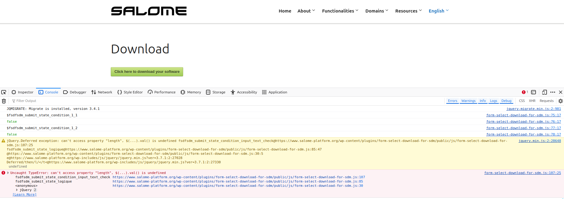

This is the error from the debug console.
thanks a lot for your valuable feedback! Escalating it.
Until the issue is resolved, here is the direct link.
