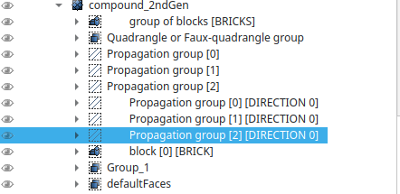

I have on the geom object browser the following:
as you can see it has ‘Group_1’ and ‘defaultFaces’
then in python i am doing:
allGroups=geompy.GetGroups(compound_2ndGen)
#then if i list my objects (input for future findObjectByPath)
['/Geometry/' + compound_2ndGen.GetName() + '/' + group.GetName() for group in allGroups]
#i am getting the following output:
['/Geometry/compound_2ndGen/        group of blocks [BRICKS]', '/Geometry/compound_2ndGen/Quadrangle or Faux-quadrangle group', '/Geometry/compound_2ndGen/Propagation group [0]', '/Geometry/compound_2ndGen/Propagation group [1]', '/Geometry/compound_2ndGen/Propagation group [2]', '/Geometry/compound_2ndGen/        Propagation group [0] [DIRECTION 0]', '/Geometry/compound_2ndGen/        Propagation group [1] [DIRECTION 0]', '/Geometry/compound_2ndGen/        Propagation group [2] [DIRECTION 0]', '/Geometry/compound_2ndGen/        block [0] [BRICK]', '/Geometry/compound_2ndGen/Group_1', '/Geometry/compound_2ndGen/defaultFaces']
#nevertheless when I do:
[ salome.myStudy.FindObjectByPath('/Geometry/' + compound_2ndGen.GetName() + '/' + group.GetName() ) for group in allGroups]
#the output is the following
[<SALOMEDS._objref_SObject object at 0x710761aadf40>, <SALOMEDS._objref_SObject object at 0x71072ffdbd00>, <SALOMEDS._objref_SObject object at 0x71072ffdbf10>, <SALOMEDS._objref_SObject object at 0x710740023880>, <SALOMEDS._objref_SObject object at 0x710740243a60>, <SALOMEDS._objref_SObject object at 0x7107402430a0>, <SALOMEDS._objref_SObject object at 0x710740243250>, <SALOMEDS._objref_SObject object at 0x71072ffc7310>, <SALOMEDS._objref_SObject object at 0x71072ffc7640>, None, <SALOMEDS._objref_SObject object at 0x71072ffc7160>]
as you can see in the element [-2] of the last output the return of the list comprehension is None, where it should not be, as it exist in the object browser. the creation of the object Group_1 i am doing it during the python script to be precise it is too long and to complex to post it. I am missing something? or how could i do it?
